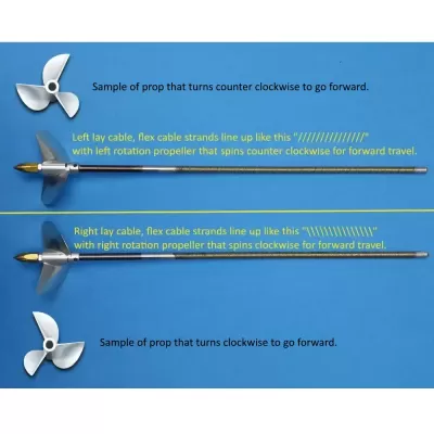

1. Rotation: Without a doubt, the biggest problem we see is customers that struggle with which is left and which is a right flex cable. HELL, we have been doing this for almost a 1/4 century and sometimes look and have to think about it, so there is no better way to explain it than the look at picture 2 and match it to what you have. At the store, we have a saying. "When reading we read from left to right, so a left rotation cable is wound with the cable going downhill, and the right rotation cable is wound going uphill." Picture 3 will explain this better.
