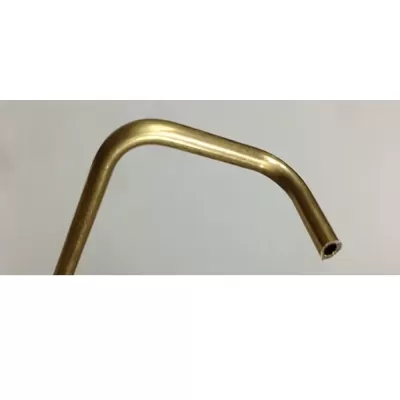

 When making 90-degree bends I use a piece of home electrical wire and place it into the tubing before bending it. The wire will stop the tubing from getting a kink in it. I take my time and work the tubing slowly. I always make a hook at the end of the wire. It makes pulling the wire out, all the easier!
This is the finished product. With the annealing process, I can almost make a pretzel out of it! When cutting the tubing, make sure to sand any shape edges. I had a sharp piece cut a hole in the rubber tubing of a boat. It took me two times to the pond to find the leak!
Things to consider. If you don't polish the tubing, you will need to sand any part of it that needs to be soldered. The blackish oxidation will prevent a solid solder.
